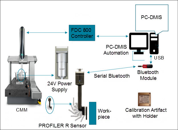

PC-DMIS offers optional software that measures roughness.
To enable this functionality, your LMS license or portlock must be configured with the appropriate option.
You can measure roughness on a Global S Chrome CMM with an LSPX 5 HD probe head, FDC 800 controller, and PROFILER R sensor.
The following diagram shows how a CMM with a PROFILER R sensor with a CMM measures roughness:
Example of a roughness measurement
You can define the roughness measurement for a device that measures tactile roughness and evaluates surface parameters according to these geometrical product specifications:
DIN EN ISO 4288:1998-041
DIN EN ISO 4287:2010-072
DIN EN ISO 13565-1:1998-043
