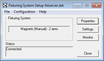

Fixturing System Setup dialog box - dual arm
There are two locations for setting parameters in a dual-arm system:
  1. Click Properties in the Fixturing System Setup dialog box, and edit the properties for both Arm1 and Arm2.
  2. Press F12 to open the Fixturing Setup dialog box in PC-DMIS, and make the appropriate changes on each tab.
