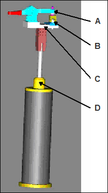

See the graphical example below.
Graphical representation of the flexible fixture unit
A - Clamp
B - End Effector
C - Module
D - Column
