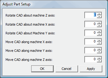

The Adjust button opens the Adjust Part Setup dialog box.
You can use this dialog box to rotate or move the CAD in increments about and along the machine's XYZ axes.
If you're rotating the CAD, then the values are in angle degrees. A value of 360 has the same effect as 0.
If you're moving the CAD, then the values are in the units of measurement that the measurement routine is in. For example, a value of 2 would mean 2 inches or 2 millimeters, depending on the units of measurement used by your measurement routine.
To adjust the CAD along or about an axis:
Click on the appropriate box.
Type a new value. PC-DMIS dynamically shows the adjustment in the Graphic Display window.
Click OK to accept the values and close the dialog box.
PC-DMIS maintains this adjustment unless you re-import the part's CAD model.
