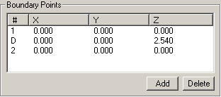

To define the boundary of a scan in the scan dialog box (Insert | Scan), PC-DMIS allows you to key in or measure points, or use CAD data.
A sample Boundary Points area
This function is only available for DCC scans.
LINEAROPEN - These scans can also be measured without an end point. Delete the end point, and PC-DMIS keeps measuring the scan until you manually stop it. You cannot delete the starting point and direction point.
LINEARCLOSE - These scans need to have the start and direction points. You cannot delete or add boundary points.
PATCH - These scans need to have at least three boundary points to create a triangular patch to work with. You can use the Add and Delete buttons in the Boundary Points area to add or delete extra points. It adds a Closed Scan check box to this area.

SECTION - Section scans use this area to set the boundary points for the SECTION scan, find holes defined in the CAD data, and toggle between displaying data for holes or for boundary points. Section scans add the Cut CAD and Show Cut buttons to this area for this purpose.

PERIMETER - These scans works the same as the LINEAROPEN scan.
ROTARY - These scans require you to have at least a start point and a direction point (shown as 1 and D respectively in the Boundary Points list and on the CAD display).
If you don't have an end point (shown as 2), PC-DMIS continues to measure the scan along the specified direction until it returns to the start point.
If you have a start point and an end point, PC-DMIS scans along the specified direction until it reaches the end point.
PC-DMIS defaults to providing you with a start, direction, and end point in the Boundary Points area. You can delete the end point, but you cannot delete the start or direction point.
