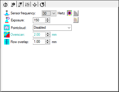

The Laser Scan Properties tab defines how PC-DMIS acquires data from the scan, and whether or not scan lines and feature visualizations appear in the Graphic Display window.
Show/Hide Stripes - This button toggles the
display of the laser stripes on the part model. Click this button to allow
the laser scan stripes to appear in real time in the Graphic Display window.
PC-DMIS limits how the stripes appear in the Graphic Display window to
the distance of the feature nominal plus the Overscan value. The software uses the Overscan value to control the amount of clipping
and the visibility of the stripe. The graphic below gives an example of
how these stripes appear.

AutoZoom ON/OFF - This button turns the laser
AutoZoom functionality on or off. Whenever you start the scan, AutoZoom
dynamically pans, zooms, rotates, and sizes the view containing the laser
data in the Graphic Display window to show the incoming data.
You can override the limitations with the up and down arrows, or enter a value into any of the boxes. However, your machine rejects invalid values and forces them to a valid number.
