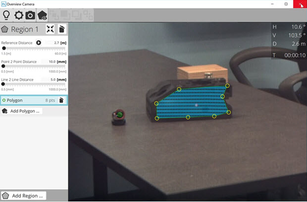

Click the Tracker Overview
Camera button
from the Tracker Operation toolbar.
Select Add Region and click the surfaces you want to scan. Right-click to end the selection.
Click to define the Reference Distance.
Click a second time to define the Point 2 Point Distance.
Click a third time to define the Line 2 Line Distance.
PC-DMIS updates the Overview Camera window to show the selected settings. The Overview Camera window shows the time (T) needed to complete the scan.
Example of the Overview Camera window
Click the X in the upper-right of the screen to close the Overview Camera window.
