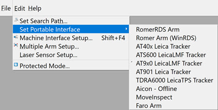

You can select or switch the portable interface at start-up.
To do this:
Start PC-DMIS but do not open a measurement routine.
From the opening PC-DMIS screen, click Edit | Set Portable Interface from the menu.
Select the portable interface you want PC-DMIS to run from the list of available interfaces. A check mark identifies the active portable interface.
You can uncheck a selected Portable interface and run PC-DMIS with no portable interface selected. In this case, the software uses the interfac.dll (if it exists) the next time PC-DMIS starts up.
When you select a device from the menu, the software dynamically switches the interface without having to close and then reopen PC-DMIS.
When you select a portable interface:
The Status bar shows the selected interface and the machine status.
