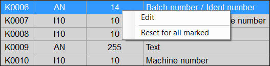

Length (editable) - This column displays the K-field’s maximum length. Q-DAS recommends the length. To change the length, right-click on the value.
Right-click menu on the MaxLength column
Edit - This option enables you to edit the value.
To set the maximum character input length, type any numeric value.
To set no limit for the maximum length, type "---" (without the quotation marks).
Reset for all marked - This option resets the length for each marked row.
