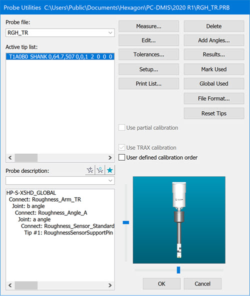

Select the components for the roughness probe in the Probe Utilities dialog box (Insert | Hardware Definition | Probe). The following is an example:
For help with this dialog box, see the "Defining Probes" topic in the "Defining Hardware" chapter in the PC-DMIS Core documentation.
Double-click on the roughness arm component in the Probe description area. (In the example above, you would double-click on Roughness_Arm_TR). The Edit Probe Component dialog box appears:
