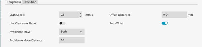

To set the execution parameters for the Roughness scan command (RGHSCN), select the Execution tab in the Roughness Scan dialog box (Insert | Scan | Roughness):
Execution tab
Scan Speed list - Select the speed at which the PROFILER R sensor can scan the part. For more information about this sensor, see "PROFILER R Roughness Sensor".
Offset Distance box - The offset distance determines the force with which the probe is held on to the part during the scan. Usually, this distance is set equal to the recommended value for the type of probe head on your machine. You should not change the offset distance unless you are very experienced with the machine and its parameters.
Use Clearance Plane switch - This switch is available if a clearance plane is active in your measurement routine. If you turn this switch to On, the Roughness scan command adds a Move Clear Plane command (MOVE/CLEARPLANE) directly before the Roughness scan command in the Edit window. For more information about this command, refer to the "Inserting a Move Clear Plane Command" topic in the "Inserting Move Commands" chapter in the PC-DMIS Core documentation.
Avoidance Move list - Select the avoidance move:
None: No avoidance moves will be used for the current feature.
Both: Before PC-DMIS measures the support point, it will first move to the specified distance above the support point, and it will move to the specified distance above the support point after the roughness scan.
Before: Before PC-DMIS measures the support point, it will first move to the specified distance above the support point.
After: After PC-DMIS completes the roughness scan, it will move to the specified distance above the support point.
Avoidance Move Distance box - The value you enter in this box defines the distance above the support point that the probe moves to during execution.
Auto Wrist switch – If you turn this switch to On, PC-DMIS calculates the best A and B angle of the wrist to measure the roughness. If you have a rotary table that uses horizontal sensor, auto wrist calculates the combination of A, B, and RT angle W. PC-DMIS inserts the required tip and Move/Rotab commands above the Roughness scan command. If you turn this switch to Off, PC-DMIS calculates the best angles required.
