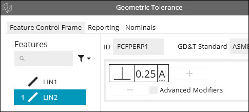

Next, create the second dimension, the perpendicularity of line 2 with CYL4 (datum A):
Select Insert | Dimension | Perpendicularity to open the Geometric Tolerance dialog box.
Set the ID to FCFPERP1.
From the Features list, choose LIN2.
In the Feature Control Frame editor, in the FCF, click on the Feature Tolerance portion, and define a tolerance of 0.25.
Click the + sign next to that to add the datum. Set it to A.
Click Create and then Cancel.

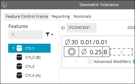

Next, create the third dimension, the concentricity of cylinder 1 with cylinder 2 (datum B):
Select Insert | Dimension | Concentricity to open the Geometric Tolerance dialog box.
Set the ID to FCFCONCEN1.
From the Features list, choose CYL1.
Click the + sign next to that to add the datum. Set it to B.

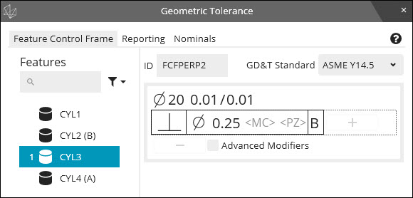

Finally, create the fourth dimension, the perpendicularity of cylinder 3 with cylinder 2 (datum B):
Set the ID to FCFPERP2.
From the Features list, choose CYL3.

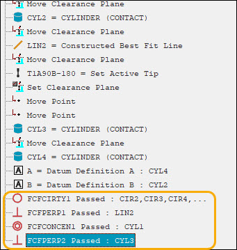

Show the Summary mode. Your measurement routine should have these datum definition and dimension commands:
