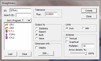

ID Feature Search ID Feature List box Last button Clear button Tolerance for Straightness Dimensions Output To area Display check box Edit button Create button Close button Units area Analysis area
Dimension Straightness dialog box
A minimum of three hits are necessary to determine the straightness of a line.
The Insert | Dimension | Straightness option calculates the straightness of a line. This dimension type is considered one sided, meaning a single positive value tolerance is applied.
To Dimension a Feature Using the STRAIGHTNESS Option:
Plus Tolerance for Straightness Dimensions
