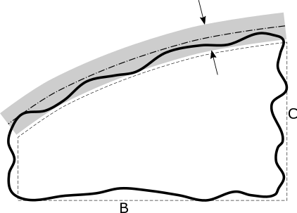

With the above specification, the specified tolerance zone looks like this:
Because this is the specified tolerance zone, the tolerance zone is not minimized, and so it does not represent the actual value. The center of the tolerance zone is offset from the nominal surface and is shown in the dashed-dotted line.
The actual value looks like this:
The center of the tolerance zone stays the same, but the zone is minimized until it just contains the actual surface.
