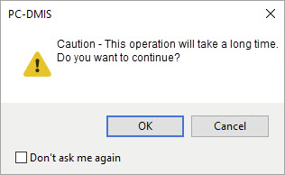

With the COPCLEAN function, if you select a large number of CAD faces, and you marked the Select option and entered a CAD Offset value in the CAD Controls area of the Pointcloud Operator dialog box, PC-DMIS displays this message:
The message indicates that if you click OK to perform the CAD Offset operation with the current settings, it will take PC-DMIS a very long time to process due to the large number of CAD faces you picked.
Select the Don't ask me again check box to prevent the message from appearing again.
Click OK to continue the operation, or click Cancel and the software will not execute the operation.
