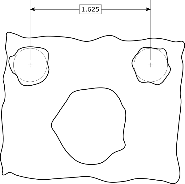

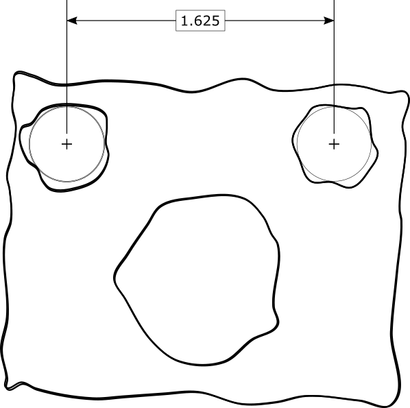

As an example of the best-fitting process, suppose you had the following specification:

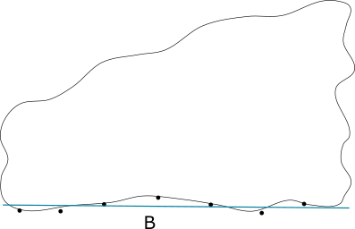

It's easier to illustrate void filtering and best fitting in 2D than 3D, so let's suppose datum B was measured as a line instead of as a plane (even though we recommend that you measure it as a plane). The measured points might look like this:

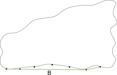

Then the void-filtered surface would look like shown below in green:
Then the best-fitted constrained least squares line (the result of the DEFAULT datum math option for ASME, or the CL2 datum math option for ISO) is best fitted to the filtered surface, and looks like this shown in blue:
By contrast, the best-fitted constrained min max line (the result of the DEFAULT datum math option for ISO) is best-fitted to the filtered surface, and looks like this shown in blue:
Meanwhile, the (unconstrained) least squares line (the result of the LSQ datum math option) is best-fitted to the original measured points, and looks like this shown in blue:
In this particular case, the DEFAULT datum math option is a better approximation to the actual datum than the LSQ datum math option. However, as seen in "Introduction to Geometric Tolerances and Feature Control Frames", the LSQ datum math option is a better approximation to the actual datum when the measurement uncertainty of each measured point is larger. Meanwhile, the CL2 math type under ISO gives a better approximation to the assembled behavior of the datum, but a poorer approximation to the actual (specified) datum.

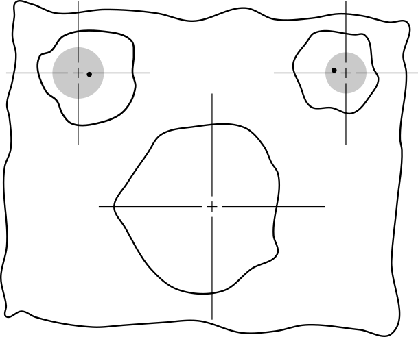

As an example of orientation constraints, suppose you had the following specification:

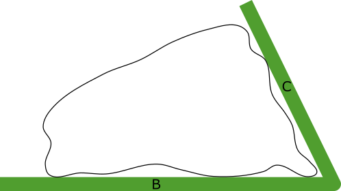

Then the actual (specified) datums for a realistic part might look like this:
Note that actual datum simulator C has the nominal angle to actual datum simulator B. Also note that the datum simulator C contacts the actual surface in exactly one point.

A frequently seen datum reference frame is the primary datum plane, followed by a secondary datum cylinder, followed by a tertiary datum cylinder. Here's an illustration of a specification, where the primary datum plane is A, the secondary datum cylinder is D, and the tertiary datum cylinder is E:
Under ASME, the secondary and tertiary datums are nominally located with respect to each other. This results in the following datum reference frame:
Under ISO (or under ASME with a translation modifier on the tertiary datum), there are no location constraints between the secondary datum D and the tertiary datum E. This results in the following datum reference frame, which has a different rotation:
The difference between the two datum reference frames is easier to see when they are superimposed on each other:

Suppose you had the following specification:
ASME
Given the above specification, the actual A | B datum reference frame under ASME is fully constrained, and looks like this:
Notice that the pattern's datum simulators are nominally located with respect to each other, and have the same size.
ISO
Given the above specification, the actual A | B datum reference frame under ISO is also fully constrained, and looks like this:
Notice that the pattern's datum simulators are nominally located with respect to each other, but do not have the same size. The overall rotation is different between ASME and ISO since the datum sizes are different.
ASME and ISO Superimposed
It's easier to see the difference between ASME and ISO when the two above images are superimposed:
ASME
In that case, the A-B common datum under ASME would look this:
Notice that the A and B simulators are exactly coaxial.
ISO
With the above specification, the A-B common datum under ISO would be different, for two reasons:
The less-important reason is that the ISO one has independent sizes.
The more-important reason is that the ISO association for common datums is constrained min-max by default. This minimizes the distance between the low points of the filtered datum surfaces and the simulators.
The ISO common datum looks like this:

Suppose you had the following specification, using a secondary datum pattern referenced at MMB:
Solving the datum reference frame might result in the this illustration:
The solid lines are the actual surface, the gray shaded areas represent the datum zones, and the small dots represent the datum axis that must be in the zone. The left datum has a bigger zone because the left actual datum hole is larger. The sizes of the zones are exaggerated to show how things work.
Since the datum axes are allowed to move within the datum zones (but not go outside them), that means the actual value for the position tolerance can be zero. Here is an illustration of how this works:
On the left is before optimization, showing the axis and tolerance zone of the big hole. On the right is after optimization, where the axis of the big hole is optimized to perfect location (yielding zero actual value) while the datum axes are forced to remain inside their zone but are not optimized.
The surfaces are shown to aid understanding, but they do not participate in the optimization. The optimization only uses the zones and the axes.
However, if the big hole has a large enough position error, the measured value will not be zero. Below is an illustration of such a case:
The big hole's actual value is optimized to be as small as possible, but the datums need to stay in their zones and so the actual value isn't zero.
