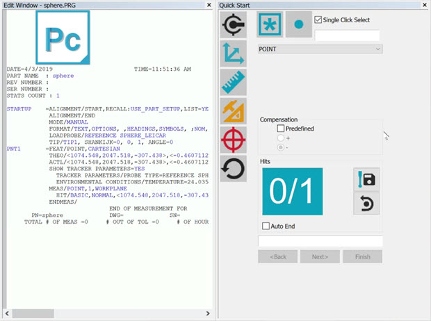

To measure the sphere centerpoint:
  1. Select the Sphere probe from the Probe list on the Settings toolbar.
  2. Point the tracker beam at the physical sphere.
  3. Click the Take Hit button or press Ctrl + H to measure the sphere. PC-DMIS returns the sphere centerpoint as the measured point.
Example of the Edit and Quick Start windows after measuring a sphere with the Sphere probe
