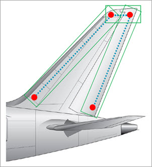

The ATS600 Line scan has two different modes which you can select from the Line Type list. For each mode, you can set the Start and End point, or multiple Start/End points to create a route.
The available modes are:
Linear - This mode is useful if you want to measure perimeters or lines. If the ATS600 is perpendicular to the measurement object and all you need to measure are lines, you can now draw them and set a value for the line width. This allows the beam to move through the different points using the fastest route instead of following each line exactly. If you need the tracker to follow a perfect line, then set the line width to its minimum value (0.5mm).
Example of a Line scan using the Linear Line Type
Crossline - This mode drives the ATS600 beam on a zig-zag route to collect points. This method is useful if you want to make pointcloud cross sections.
Example of a Line scan using the Crossline Line Type

Line Scan example
