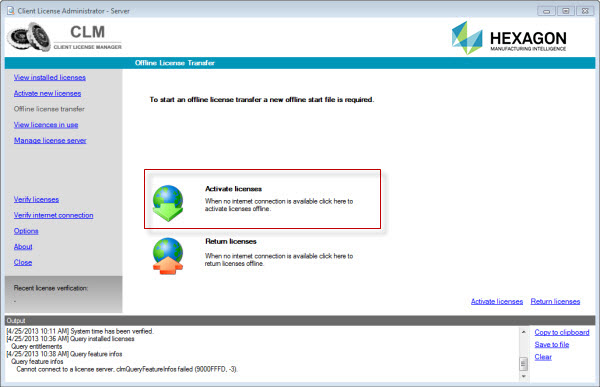

To get the offline activation .clmreq file:
Start the appropriate CLM Administration application described above, and click the Offline license transfer option.
Click Activate licenses on the next screen.

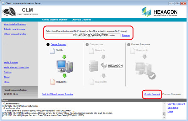

On the next screen, click Browse, and navigate to the .clmstart file that you copied to your portable storage device.
Click the file to select it, and then click Create Request in the lower-right area.

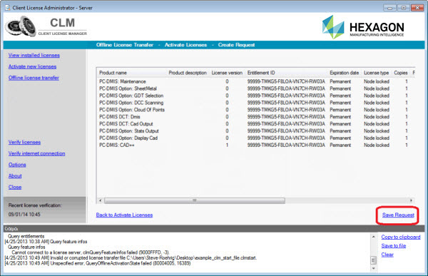

Once the request has been generated, the license details appear.
Click Save Request in the lower right to save the .clmreq file.
You use the .clmreq file to get the .clmresp response file.
