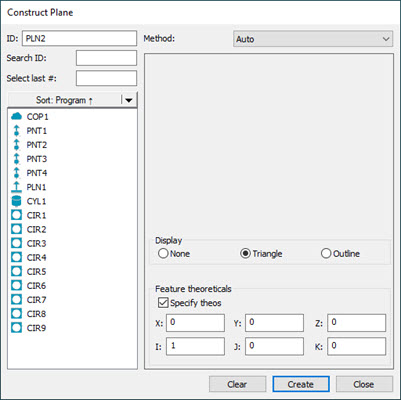

Constructing a Plane Feature
Construct Plane dialog box
There are several methods to use PC-DMIS to construct a plane. The following table lists the various types of constructed planes along with their necessary inputs. Some features may require no inputs, while others may require three or more inputs. In the following table, the term "Any" indicates that the construction can take any type of feature as input for construction. PC-DMIS allows the features to be selected in any order.

To construct a plane, do the following:
  1. Open the Construct Plane dialog box (Insert | Feature | Constructed | Plane).
  2. Use the Method list to select the method type for the constructed plane. The available options are:
  1. Use the table above to select the appropriate features from the Feature list for the constructed plane based on the selected method.
  2. Make the necessary changes to other options that become available based on the selected method for the constructed plane. These are described in the topic specific to the method you selected.
  1. From the Display area, select how you want PC-DMIS to display the constructed plane. For details, see the "Using the Display Area" topic in this documentation.
  2. If you want to change the feature theoretical values, select the Feature theoreticals check box and type in the values. For details, see the "Specifying Feature Theoreticals" topic in this documentation.
  3. Click the Create button.
The Edit window command line for a sample plane construction would read:
feature_name=FEAT/PLANE,TOG
THEO/x_cord,y_cord,z_cord,i_vec,j_vec,k_vec
ACTL/x_cord,y_cord,z_cord,i_vec,j_vec,k_vec
CONSTR/TOG2,TOG3,...
