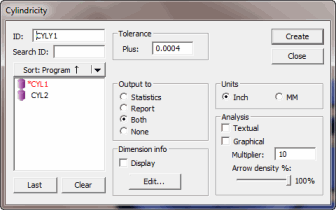

ID Feature Search ID Feature List box Last button Clear button Tolerances for Roundness Dimensions Output To area Display check box Edit button Create button Close button Units area Analysis area
Dimension Cylindricity dialog box
The Insert | Dimension | Cylindricity menu option determines the cylindricity of a cylinder. This dimension type is considered one sided, meaning a single positive value tolerance is applied.
