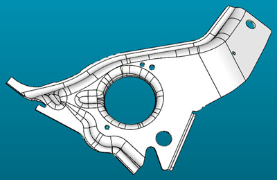

Sheet metal - Select this option for sheet metal parts which mainly have freeform surfaces.
Example of a sheet metal part for UniScan

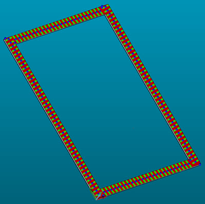

Segmented - This option is only available when you have a CMS probe head with a C-joint. This strategy is for parts that have large holes. It sub-divides the patch using the same tip into areas that can be scanned along their longest direction. This reduces the number and length of scans.
Example of a segmented part for UniScan

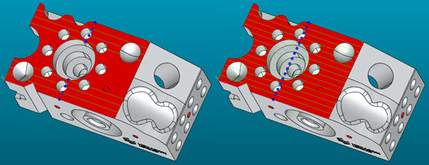

Split lines check box and input box - When you select this check box and enter a value, scan paths are split when the distance between two consecutive points is larger than this value. This value should reflect the minimum size of the hole that the scan path should skip. When you click on a surface, this field is initialized with the size of the of the largest hole if any.
Example with the Split lines option enabled (left) and disabled (right)

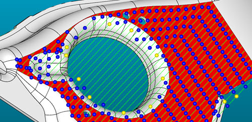

The yellow control points in this image are the control points that PC-DMIS assigns a faster speed to when it performs the UniScan:
Example of yellow control points which you can apply a faster scan speed to with the Speed in void option
