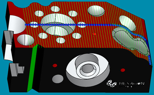

The UniScan performs the scan analysis based on the machine volume if you have an insert machine command in your measurement routine. If your part is located in such a way that some areas of the selected faces cannot be scanned due to machine volume limits, PC-DMIS notifies you. The software colors these areas black to inform you that they could not be scanned due to the part's position in the machine's volume.
Example of a UniScan with unable to scan areas shown in black

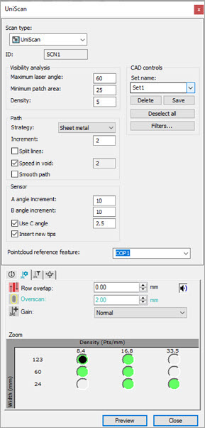

  1. Open the UniScan dialog box (Insert | Scan | UniScan).
UniScan dialog box
  1. Make the necessary changes to the scan properties. For details on the UniScan dialog box properties, see "Description of the UniScan Dialog Box".
  2. Select the surfaces that you want to scan or select the set name from the Set name list in the dialog box.
  3. Click the Preview button to perform a scan analysis on the selected surfaces. When PC-DMIS finishes the scan analysis, PC-DMIS displays a message about the scan details and prompts you to create the scan.
  4. Click Yes to create the scan, or No to return to the dialog box. If you click Yes, PC-DMIS creates the scan command in the Edit window and the Graphic Display window shows the scan on the selected surfaces.

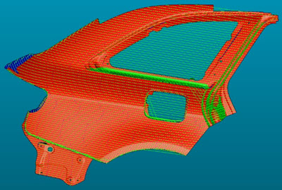

Example of the UniScan after scan analysis is completed but before scan is created

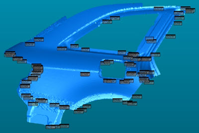

Example of the UniScan after the scan is created and executed
