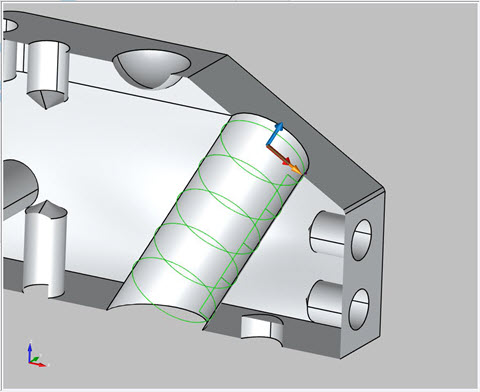

One possibility for producing data in sections is to use 2D cross section features like circles and 2D widths. The other possibility is to use a measurement strategy that produces data in sections, such as "Default PC-DMIS Measurement Strategy" or "Adaptive Cylinder Concentric Circle Scan". For more information on measurement strategies, see the "Working with Measurement Strategies" topic in the "PC-DMIS CMM" documentation.

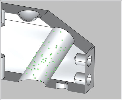

For cylinders, the command attempts to partition the data into circular cross sections. The data must be arranged in circles or the command will fail.

When partitioning cylindrical data, the command first projects the points onto the cylinder's axis. It then identifies clusters of projected points as belonging to the same cross section.
