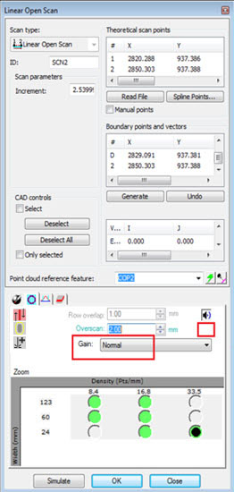

Consider this example:
The Quality Filter button is hidden when the Gain is set to Normal

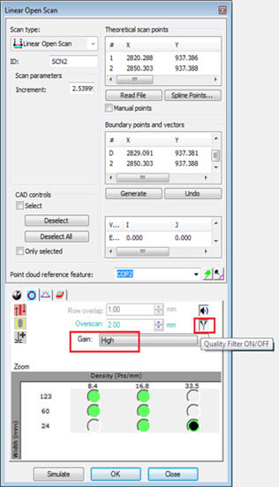

In this example:
The Quality Filter button is visible when the Gain is set to High
