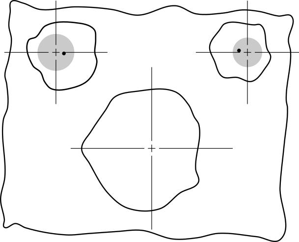

The [DF] modifier is not standardized. This means it is not in any published ISO standard. The modifier has been introduced in some unpublished drafts of ISO 5459. In those drafts, [DF] stands for "Distance Fixed". This means the datum location is constrained to any higher-precedence datum or datums, overriding the default variable distance. Even though this modifier is not part of the standard, we found that this modifier is necessary to support several ISO functional requirements, especially plane-circle-width datum reference frames (and width variations like slots and mid-lines).

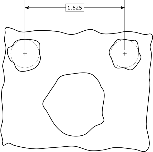

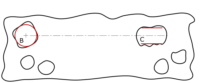

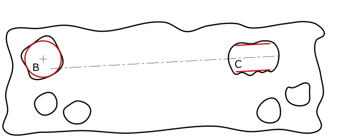

Without the modifier, the orientation of the slot fully controls the in-plane rotation angle. This gives unstable, non-functional results (especially when the slot is short).

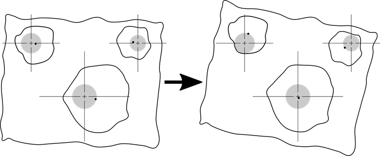

With the modifier, the actual angle from the circle to the slot controls the in-plane rotation angle. This is the functional intent.

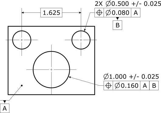

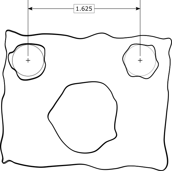

Suppose you have the following ISO specification, where the primary datum is A, the secondary datum is B, and the tertiary datum is C:
With No Modifiers
Of course, the real part has location, orientation, and form errors on the real surface. With no modifiers, the datum reference frame looks like the image below. The in-plane rotation angle comes completely from the orientation of datum C. Often, this makes the in-plane rotation angle unstable. This is because small variations in C lead to large changes in the in-plane rotation angle:

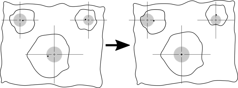

With the [DF] Modifier
For this datum reference frame, usually datum C needs a [DF] modifier. The modifier constrains the datums' relative location. This constraint makes datum C coplanar with datum B. This matches the typical functional intent and makes the datum reference frame more stable:

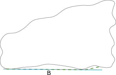

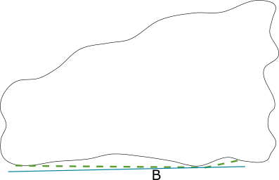

As an example of the best-fitting process, suppose you had the following specification:

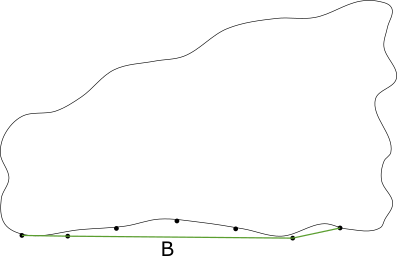

It's easier to illustrate void filtering and best fitting in 2D than 3D, so let's suppose datum B was measured as a line instead of as a plane (even though we recommend that you measure it as a plane). The measured points might look like this:
Then the void-filtered surface would look like shown below in green:

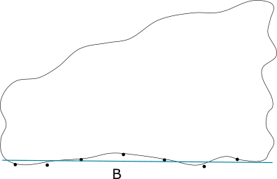

Then the best-fitted constrained least squares line (the result of the DEFAULT datum math option for ASME, or the CL2 datum math option for ISO) is best fitted to the filtered surface, and looks like this shown in blue:
By contrast, the best-fitted constrained min max line (the result of the DEFAULT datum math option for ISO) is best-fitted to the filtered surface, and looks like this shown in blue:
Meanwhile, the (unconstrained) least squares line (the result of the LSQ datum math option) is best-fitted to the original measured points, and looks like this shown in blue:
In this particular case, the DEFAULT datum math option is a better approximation to the actual datum than the LSQ datum math option. However, as seen in "Introduction to Geometric Tolerances and Feature Control Frames", the LSQ datum math option is a better approximation to the actual datum when the measurement uncertainty of each measured point is larger. Meanwhile, the CL2 math type under ISO gives a better approximation to the assembled behavior of the datum, but a poorer approximation to the actual (specified) datum.

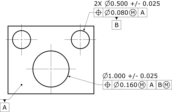

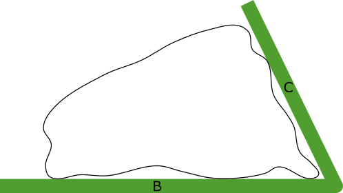

As an example of orientation constraints, suppose you had the following specification:
Then the actual (specified) datums for a realistic part might look like this:
Note that actual datum simulator C has the nominal angle to actual datum simulator B. Also note that the datum simulator C contacts the actual surface in exactly one point.

For cylinders, the actual datum simulator is defined by ASME Y14.5.1 - 2019. A perfect cylinder is fitted to the actual surface using constrained least squares.
There is no void filtration. This fit makes the simulator external to the material while it maximizes contact and stability. In cases where the actual surface would rock, the constrained least squares definition produces a stabilized solution.
Secondary and tertiary actual datum cylinder simulators are nominally constrained in orientation and location to higher-precedence datum simulators. When a translation modifier is present, secondary or tertiary datum cylinders are not restricted in location compared to higher-precedence datum simulators, but they remain constrained in orientation.
When datum cylinders have surface data, PC-DMIS computes a measured approximation to the actual datum using that surface data and using the chosen datum math option. For details on the cylinders that have surface data, refer to "Feature Types With and Without Surface Data".
For cylinders, the actual datum simulator is defined by ISO 5459 - 2011, using the phrase "associated datum feature." The actual surface is filtered to remove dents and other voids, and then a perfect cylinder is fitted to the filtered surface using a maximum-inscribed (inner cylinders) or minimum-circumscribed (outer cylinders) formula. This fit makes the simulator external to the material, and can be considered a mating envelope.
Unfortunately, inscribed and circumscribed algorithms are notoriously unstable, and so PC-DMIS, with the DEFAULT datum math type, uses a constrained least squares algorithm to inscribe or circumscribe this type of datum feature. The constrained least squares algorithm produces almost the same diameter as a pure inscribing or circumscribing, but the algorithm is much more stable. Therefore, DEFAULT and CL2 datum math types are the same for this type of datum feature.
Secondary and tertiary actual datum cylinder simulators are nominally constrained in orientation to higher-precedence datum simulators. They are not restricted in location compared to higher-precedence datum simulators unless the datum has a [DF] modifier. When the datum has a [DF] modifier, the simulators are nominally constrained in orientation and location to the higher-precedence datum simulators.
A frequently seen datum reference frame is the primary datum plane, followed by a secondary datum cylinder, followed by a tertiary datum cylinder. Here's an illustration of a specification, where the primary datum plane is A, the secondary datum cylinder is D, and the tertiary datum cylinder is E:
Under ASME (or under ISO with a [DF] modifier on the tertiary datum), the secondary and tertiary datums are nominally located with respect to each other. This results in the following datum reference frame:
Under ISO (or under ASME with a translation modifier on the tertiary datum), there are no location constraints between the secondary datum D and the tertiary datum E. This results in the following datum reference frame, which has a different rotation:
The difference between the two datum reference frames is easier to see when they are superimposed on each other:

For widths, the actual datum simulator is defined by ASME Y14.5.1 - 2019. A perfect width is fitted to the actual surface using constrained least squares.
Secondary and tertiary actual datum width simulators are nominally constrained in orientation and location to higher-precedence datum simulators. When a translation modifier is present, secondary or tertiary datum widths are not restricted in location compared to higher-precedence datum simulators, but they remain constrained in orientation.
All widths in PC-DMIS have surface data. PC-DMIS computes a measured approximation to the actual datum using that surface data and using the chosen datum math option.
When possible, use the 3D width type. This is because it represents the entire width surface. When the width is too shallow to measure as a 3D width, you can use a 2D width as a secondary or tertiary datum. You should not use a 2D width as a datum until higher precedence datums have defined the workplane of the 2D width. 2D widths as datums have the same cautions as described in "Datum Plane Cross-Sections".
When the width is too small to use even as a 2D width, you can use a 1D width as a tertiary datum. Higher precedence datums must have completely defined the orientation of the 1D width surface. 1D widths have the same cautions as described in "Datum Plane Samples".
For widths, the actual datum simulator is defined by ISO 5459 - 2011, using the phrase "associated datum feature." The actual surface is filtered to remove dents and other voids, and then a perfect width is fitted to the filtered surface using a maximum-inscribed (inner widths) or minimum-circumscribed (outer widths) formula. This fit makes the simulator external to the material, and can be considered a mating envelope.
Secondary and tertiary actual datum widths simulators are nominally constrained in orientation to higher-precedence datum simulators. They are not restricted in location compared to higher-precedence datum simulators unless the datum has a [DF] modifier. When the datum has a [DF] modifier, the simulators are nominally constrained in orientation and location to the higher-precedence datum simulators.

Datum patterns consist of features of size (cylinders, circles, widths, and spheres) that have the same nominal size, size tolerance, and are all inner or all outer. The datum simulators for the pattern are nominally oriented and located with respect to each other.
Under ASME Y14.5, the sizes of the simulators match each other because the nominal sizes and size tolerances and the in and out options are all the same. This is because paragraph 7.12.4 of ASME Y14.5 2018 states that the simulators must grow and shrink simultaneously. The set of actual datum simulators is defined by a constrained least squares fit. The fit is applied to the features' surfaces simultaneously, keeping the nominal location and orientation between each simulator as well as keeping the sizes matched. There is no void filtration.
ISO 5459 does not clearly state whether the simulators must have matched sizes or independent sizes. In our interpretation, the sizes are independent for ISO datum simulators within a pattern. See the example after paragraph 6.2.3 of ISO 5459 : 2011, as well as Figure A.8 which informed our interpretation. The set of actual datum simulators is defined by a constrained min max fit. The fit is applied to the features' void-filtered surfaces simultaneously, keeping the nominal location/orientation between each simulator, but allowing the sizes to vary independently.
Suppose you had the following specification:
ASME
Given the above specification, the actual A | B datum reference frame under ASME is fully constrained, and looks like this:
Notice that the pattern's datum simulators are nominally located with respect to each other, and have the same size.
ISO
Given the above specification, the actual A | B datum reference frame under ISO is also fully constrained, and looks like this:
Notice that the pattern's datum simulators are nominally located with respect to each other, but do not have the same size. The overall rotation is different between ASME and ISO since the datum sizes are different.
ASME and ISO Superimposed
It's easier to see the difference between ASME and ISO when the two above images are superimposed:

Under ASME Y14.5, the set of actual datum simulators is defined by a constrained least squares fit to the features' void-filtered surfaces simultaneously. This fit also keeps the nominal location/orientation between each simulator.
Under ISO 1101, the set of actual datum simulators is defined by a constrained min max fit to the features' void-filtered surfaces simultaneously, keeping the nominal location and orientation between each simulator.

Suppose you had the following specification, using a secondary datum pattern referenced at MMB:
Solving the datum reference frame might result in the this illustration:
The solid lines are the actual surface, the gray shaded areas represent the datum zones, and the small dots represent the datum axis that must be in the zone. The left datum has a bigger zone because the left actual datum hole is larger. The sizes of the zones are exaggerated to show how things work.
Since the datum axes are allowed to move within the datum zones (but not go outside them), that means the actual value for the position tolerance can be zero. Here is an illustration of how this works:
On the left is before optimization, showing the axis and tolerance zone of the big hole. On the right is after optimization, where the axis of the big hole is optimized to perfect location (yielding zero actual value) while the datum axes are forced to remain inside their zone but are not optimized.
The surfaces are shown to aid understanding, but they do not participate in the optimization. The optimization only uses the zones and the axes.
However, if the big hole has a large enough position error, the measured value will not be zero. Below is an illustration of such a case:
The big hole's actual value is optimized to be as small as possible, but the datums need to stay in their zones and so the actual value isn't zero.
When you reference a datum with a material boundary modifier, the geometric tolerance command needs to compute the size of the material boundary unless the material boundary size is specified. The material boundary size is based on the size tolerance of the datum feature and the applicable geometric tolerances.
For datums with a maximum material modifier, you start with the maximum material condition size. This is the upper limit of size for outer features, and the lower limit of size for inner features. Then you adjust this size by the applicable geometric tolerance.
For datums with a least material modifier, you start with the least material condition size. This is the lower limit of size for outer features, and the upper limit of size for inner features. Then you adjust this size by the applicable geometric tolerance.
For material boundaries that contain the feature surface, the applicable geometric tolerance increases the size of the material boundary. This is for outer features with a maximum material modifier and for inner features with a least material modifier.
For material boundaries that are contained by the feature surface, the material boundary size is decreased by the applicable geometric tolerance. This is for inner features with a maximum material modifier and for outer features with a least material modifier.
The rules that determine which geometric tolerance to apply, if any, are complicated. They are described in ISO 2692 and incompletely described in ASME Y14.5. The PC-DMIS rules are shown below. In the ISO case, the rules are adapted to the tolerance types that PC-DMIS supports. In the ASME case, the rules are extrapolated from the incomplete description in Y14.5.
For primary datums with ISO, we adjust the material boundary by the form tolerance at the same material condition, if it exists:
If the primary datum is a cylinder, we use the axis straightness at the same material condition, if it exists.
If the primary datum is a sphere or width, we ignore the form tolerance and do not adjust the material boundary.
If the primary datum is A
and datum
cylinder A is a shaft and has an axis straightness at
the maximum material boundary is the maximum size of the shaft plus the
axis straightness tolerance.
For secondary datums with ISO, we adjust the material boundary by the orientation or location tolerance at the same material condition that references the same primary datum, with the same datum modifiers, and that does not have any secondary datum. All other tolerances are ignored. If more than one such tolerance exists, the material boundary adjustment uses the smallest such tolerance.
For tertiary datums with ISO, we adjust the material boundary by the orientation or location tolerance at the same material condition that references the same primary datum, with the same datum modifiers, and that references the same secondary datum, with the same datum modifiers, and that does not have any tertiary datum. All other tolerances are ignored. If more than one such tolerance exists, the material boundary adjustment uses the smallest such tolerance.
For primary datums with ASME, we adjust the material boundary by the axis straightness form tolerance, if it exists. We do not adjust the material boundary for spheres and widths.
and datum
cylinder A is a shaft and has an axis straightness, the maximum material
boundary is the maximum size of the shaft plus the axis straightness tolerance.

An ASME datum with a translation modifier, or an ISO datum without a [DF] modifier, has unrestricted translation compared to higher-precedence datum simulators. Both the ASME and ISO standards are unclear about what this means when there are any datums referenced with a material modifier.
Suppose we take a primary datum plane, a secondary datum circle at maximum material, and a tertiary datum circle without a material modifier but with translation allowed. There are two possible interpretations:
We could evaluate the datum reference frame independent of the position tolerance; we optimize the B-C distance so that B is optimally centered in its hole, and then we keep that distance constant while evaluating the position tolerance.
We could evaluate the datum reference frame simultaneously with the position tolerance; while optimizing the position tolerance we allow the B-C distance to vary until the position tolerance measured value is as small as possible.
In PC-DMIS, we use the first interpretation because it is more conservative (the measured values are larger).
