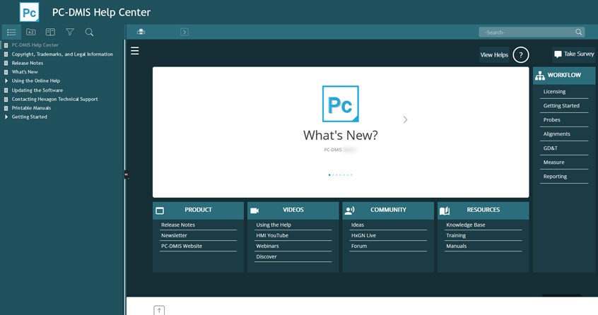

The PC-DMIS Help initially shows the Help Center introductory topic. This topic contains helpful links to internal and external topics and resources:
The PC-DMIS Help File - Introductory Topic

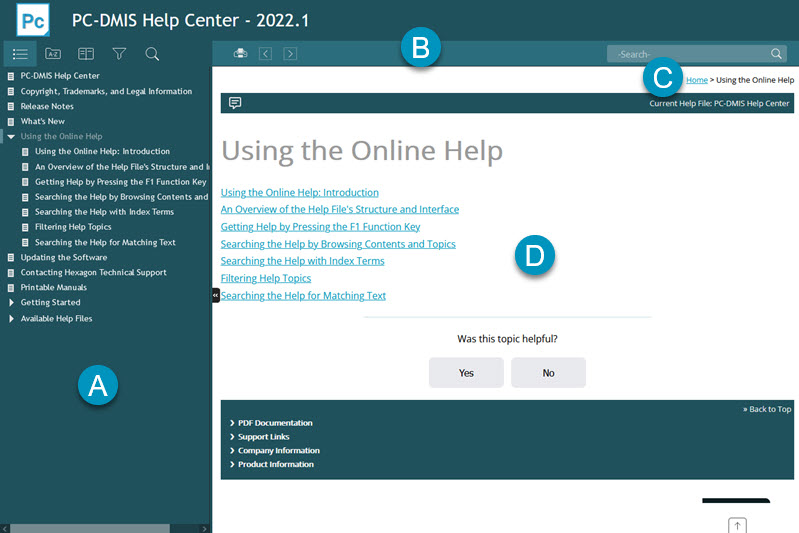

A typical topic contains these main areas:
The navigation pane displays tabs to help you navigate,
search for, and filter topics. You can click Collapse
) to hide the pane or click Expand
to show the Navigation pane.
You can adjust the width of the navigation pane.
Click on the right border of the pane.
Drag the border to the left or to the right to the desired width.
If you use a Firefox browser, to increase the navigation pane's width, drag slowly and carefully to the right; otherwise you may experience a problem where your pointer temporarily cannot drag the border until you click on it again. This is a known issue with Adobe's underlying code.
From left to right, the navigation pane contains these tabs:
Table of Contents - This tab allows you to search by contents. See "Searching the Help by Browsing Contents and Topics".
Index - This tab allows you to search by alphabetized index entries. See "Searching the Help with Index Terms".
Glossary - This tab displays definitions of various terms used in the Help.
Filter - This tab allows you to customize the Help to better suit your needs so that you're not presented with so many topics when you browse through the Table of Contents or search the Help. See "Filtering Help Topics".
Search - This tab allows you to search for matching text. See "Searching the Help for Matching Text".
The Toolbar at the top of the Help viewer contains these buttons:
Print - This button lets you print the contents of the Topic pane. It displays a standard Print dialog box where you can choose the printer to accept the topic's content. This is good for quick printouts of a few topics.
Back (
/ Forward (
) - These
buttons move back and forward through main sections (or chapters)
of a Help file.
Search - This behaves the same as the Search tab. You can type a word or a series of words to search in the Help, and then click the search magnifying glass button to display relevant topics. See "Searching the Help for Matching Text".
On typical topics, the Breadcrumbs area exists between the Toolbar area and Topic pane:
Breadcrumbs provide you with a hierarchal view of where the topic is in context with its direct-line ancestor topics. This provides you with a convenient way to view earlier parent topics within the topic's current tree level in the Table of Contents tab. You can click the Home link to go to the initial introductory topic of the current Help file.
This area does not exist in the introductory topic.
The Topic pane is the main part of the Help. It displays the contents for the selected topic.
