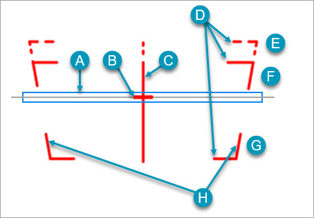

Visual Guide Output - The Visual Guide Output projects an overlay onto the scan area to show the region on your part or CAD model that the HP-L-10.10 sensor measures. This helps to pinpoint an area or a specific feature of interest when you move the sensor with a jog box or when you perform a measurement in CNC mode.
The components of the Visual Guide are:
A - Laser scan line
B - Stand off indicator
C - Mid-line
D - Distance indicators
E - Extended distance (Stand Off: 90 mm + 60 mm)
F - Far distance (Stand Off: 90 mm + 30 mm)
G - Near distance (Stand Off: 90 mm - 30 mm)
H - Max measuring width indicator
