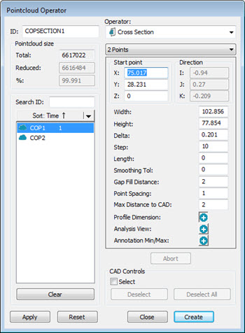

You can create a cross section between two points with the 2 Points function from the Pointcloud Operator or Mesh Operator dialog box.
Pointcloud Operator dialog box - Cross Section Operator, 2 Points function selected
PC-DMIS creates the 2 Points cross section between two selected points and orients it normal to the current Graphic View. The cross section's purple Length line is perpendicular to the line defined by the two points you select. It is created at the midpoint of this line and defaults to 0 (zero).

  1. For cross sections created with a COP as the input, click Insert | Pointcloud | Operator to display the Pointcloud Operator dialog box.
For cross sections created with a Mesh as the input, click Insert | Mesh | Operator to display the Mesh Operator dialog box.
  1. From the Operator list, select the Cross Section operator.
  2. Under the Operator list, from the drop-down list, select the 2 Points function.
