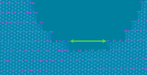

Max Triangle Size - The software uses this value to recognize holes or gaps in the pointcloud data. If the distance between any two points is greater than this value, the software does not create any triangles in that area. If there are hole features on your part, you typically need to set this value to be slightly smaller than the smallest hole. This prevents the mesh display from filling the hole (see the image below).
The default value for the Max Triangle Size is 5 mm. The software converts this to inches if your measurement routine is using that unit. Valid range values depend on the size of the part.
This example shows the distance between the two points is greater than the Max Triangle Size value. PC-DMIS does not create any triangles in this area.
Blue triangles = Mesh Display. The size of the blue triangles is determined by the Grid Size value.
Purple points = Scanned points.
