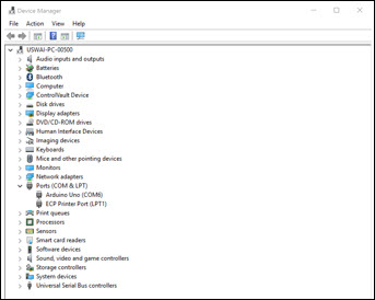

To ensure that the Arduino UNO appears as a COM port, do the following:
  1. Open Device Manager.
  2. Ensure that the Arduino UNO appears as a COM port:
