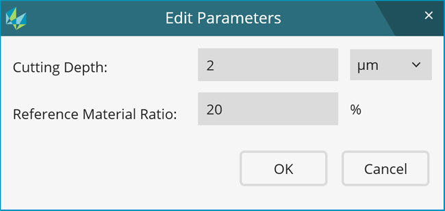

Axis Rmr, Wmr, Pmr - An evaluation of Rmr needs additional parameters. In the Results area, click the Edit icon on the Rmr row to open the Edit Parameters dialog box.
Cutting Depth - Type the value. The value you enter is in the units you select from the list. The list contains these items: microns, % of Rt, or % of Rz.
Reference Material Ratio - Type the value. PC-DMIS calculates Rmr based on the input values.
