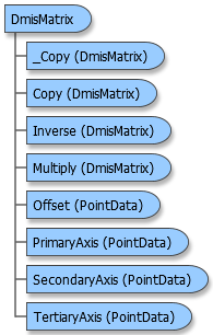

The DmisMatrix object is a four by three array of doubles modeled after the transformation matrices used in PC-DMIS. The first set of three doubles represents the matrix offset. The second set of three doubles represents the X axis. The third set of three doubles represents the Y axis. The fourth set of three doubles represents the Z axis.
Object Model
DmisMatrix ObjectDmisMatrix ObjectDmisMatrix ObjectDmisMatrix ObjectDmisMatrix ObjectPointData ObjectPointData ObjectPointData ObjectPointData Object
