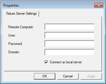

From the Fixturing System Setup window, select Configuration | Connection to open the Properties dialog box. This dialog box defines the connection properties and settings to the fixture server. For more information, see "Fixture Server Connection".
From the Fixture Server Settings tab in the Properties dialog box, define the Remote computer, the User, the Password, and if needed, the Domain.
Properties dialog box - Fixture Server Settings tab
Remote Computer - To connect to a remote server, type the name of the remote computer. To connect to a local server running on your computer, type localhost.
User - Type a username with administrator access. Do this even if you're connecting to a local server.
Password - Type the password the user uses to log in. Do this even if you're connecting to a local server.
Domain - If needed, specify the domain name.
Connect as local server - If you're connecting to a local server, mark this check box. If you're connecting to a remote server, clear this check box.
Click OK to connect to the server with your login credentials.

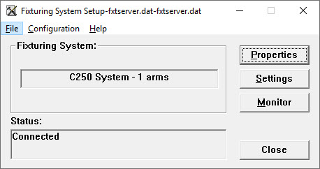

Click OK to close the dialog box. The Fixturing System Setup application shows what you selected in the Fixturing System area.
Example of a C250 System with a single arm on a bridge machine
From the Fixturing System Setup application, click Properties to open the Fixture Properties dialog box.
