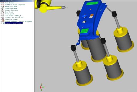

Graphical example of five flexible fixtures holding a car part
For example, a car door might have a fixture that holds a door at the hinge locations and then also at the latch on the other side. The door is placed in this holding device on the CMM and then it is inspected.

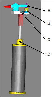

Basically, two parts create each flexible fixture.
The column: There may be several different sizes that handle the different areas within the workspace.
The module that fits on top of the column: These can be created from the standard set that the manufacturer supplies, or they can be custom designed to fit your specific needs. Many modules include clamps that hold the part to the module.
The end effector is an artifact placed against the part to hold it stationary in at least one axis. Typically, this is a sphere with a defined diameter. Spheres are used because they only contact the part at a single location. Other types of end effectors can be pins for mating holes, cylinders for locating edges, and special pieces that are specifically tailored to the part that the fixtures are holding.
The module is usually a cube with some geometry that is created in a specific way to contact the part in a predefined location.
See the graphical example below.
Graphical representation of the flexible fixture unit
A - Clamp
B - End Effector
C - Module
D - Column
