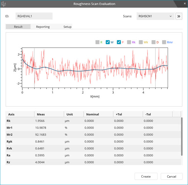

To dimension roughness and create a Roughness Evaluation command, follow these steps:
  1. Select Insert | Dimension | Roughness to open the Roughness Evaluation dialog box.
  2. Roughness Evaluation dialog box
  3. Complete the options:
  4. Use these tabs to view the results, set the reporting options, and select the desired characteristics to display on the report:
  5. To insert the Roughness Evaluation command into the Edit window, click the Create button. To cancel your changes, click the Cancel button.
  6. The OK button appears if you edit the Roughness Evaluation command.
