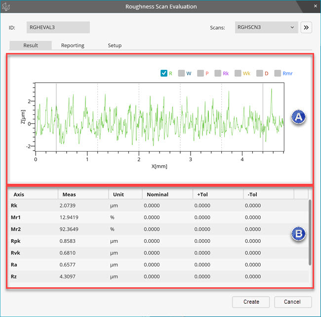

The Result tab in the Roughness Evaluation dialog box (Insert | Dimension | Roughness) displays the calculated roughness characteristics.
The top area of the Result tab displays the plot, and the bottom area displays the results of the measurement.
Result tab
Plot area - This top area lets you select the check boxes to display one or more plots. If you position your mouse pointer over any check box, the tooltip displays the information about it. The Rmr plot is always combined with R plot. The PC-DMIS report also displays the same plot.
Results area - This bottom area shows the results of the characteristics selected in the Setup tab.

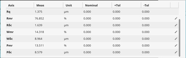

Axis Rmr, Wmr, Pmr - An evaluation of Rmr needs additional parameters. In the bottom Results area, click the Edit icon on the Rmr row to open the Edit Parameters dialog box.
Cutting Depth - Type the value. The value you enter is in the units you select from the list. The list contains these items: microns, % of Rt, or % of Rz.
Reference Material Ratio - Type the value. PC-DMIS calculates Rmr based on the input values.
