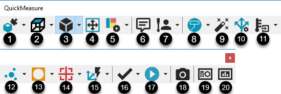

The Portable QuickMeasure toolbar models the typical flow of operation for Portable users. To access it, select View | Toolbars | QuickMeasure.
The toolbar provides drop-down functionality for many of the buttons. PC-DMIS stores the last-selected option for each button and displays it the next time the software shows the QuickMeasure toolbar.

The following buttons are available:
1. CAD Setup button and drop-down arrow - Provides options to set up the CAD model.
Click the small black arrow to display the CAD Setup toolbar:

2. Graphic View button and drop-down arrow - Resets the Graphic Display window to the graphical view shown on the button.
Click the small black arrow to display the Graphic View toolbar:

3. Graphic Items button and drop-down arrow - Changes the Graphic Display window to display or hide the graphical item properties shown on the button.
Click the small black arrow to display the Graphic Items toolbar:

4. Scale to Fit (Ctrl + Z) - Re-draws the part image to fit entirely within the Graphic Display window. This function is useful whenever the image becomes too large or small. You can also re-draw the image by pressing Ctrl + Z on your keyboard.
5. Graphic Viewset button and drop-down arrow - Depending on the button icon that is displayed, when clicked, the current Viewset can be saved, or an existing Viewset can be recalled.

6. Opens the Comment dialog box so you can insert different comment types into the measurement routine. By default, the software selects the Operator option.

7. Probe Mode button and drop-down arrow - Sets and adds the Probe Mode feature that is displayed on the button to the measurement routine.
Click the small black arrow to display the Probe Mode toolbar where you can select between Manual Mode and DCC Mode.

8. Graphic Modes button - Sets the screen mode that is related to the icon shown on the button, either Program Mode or Translate Mode.

9. Quick Start toggle button - Toggles the Quick Start functionality on and off. For details, see the "Quick Start Interface" topic in the "Using Other Windows, Editors, and Tools" chapter in the PC-DMIS Core documentation.
10. Measurement Strategy Editor button - Opens the Measurement Strategy Editor dialog box so that you can modify the settings for all auto features and store them as custom groups. For details, see the "Using the Measurement Strategy Editor" topic in the "Setting Your Preferences" chapter in the PC-DMIS Core documentation.
11. Gage button - Opens the Gage dialog box to add a Caliper or Temperature command into the current measurement routine.
Click the small black arrow to display the Gage toolbar.

12. Auto Feature button and drop-down arrow - Displays the Auto Feature dialog box that is related to the icon shown on the button. From the dialog box, you can select any of the available feature commands to insert into the measurement routine.
Click the small black arrow to display the Auto Feature toolbar:

13. Constructed Feature button and drop-down arrow - Displays the Constructed Feature dialog box that is related to the icon shown on the button. From the dialog box, you can select any of the available feature commands to insert into the measurement routine.
Click the small black arrow to display the Constructed Feature toolbar:

14. Dimension button and drop-down arrow - Displays the Dimension dialog box that is related to the icon shown on the button. From the dialog box, you can select any of the available dimension commands to insert into the measurement routine.
Click the small black arrow to display the Dimension toolbar:

15. Alignment button and drop-down arrow - The alignment options are defined based on the types of features that you selected, the order in which you selected them, and the positions of the features relative to each other.
Click the small black arrow to display the Alignment toolbar:

16. Mark button and drop-down arrow - Depending on the selection you made on the drop-down toolbar, the button marks the currently selected feature, marks all features, or clears all marked features in the Edit window.
Click the small black arrow to display the Mark toolbar:

17. Execute button and drop-down arrow - Runs (or executes) the measurement process for any currently marked feature(s).
Click the small black arrow to display the Execute toolbar:

18. Snapshot button - Inserts a SNAPSHOT command of the current Graphic Display window state into the Edit window. When you execute this command, it inserts an image capture at that state into your report. For more information see "Inserting Snapshots" in the "Inserting Report Commands" chapter in the PC-DMIS Core documentation.
19. Status Window - Displays the Status window. You can use this window to preview commands and features while you create them from the Quick Start toolbar, during feature execution, dimension creation or editing, and also by simply clicking on the item in the Edit window with the Status window open. For details on the Status window, see the "Using the Status Window" topic in the "Using Other Windows, Editors, and Tools" chapter in the PC-DMIS Core documentation.
20. Report Window - Displays the Report window. After execution of the measurement routine, this window displays your measurement results and automatically configures the output according to a default report template. For detailed information, see "About the Report Window" in the "Reporting Measurement Results" chapter in the PC-DMIS Core documentation.
