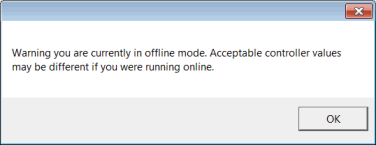

If PC-DMIS is currently in Offline
mode, the following warning message appears. The message indicates that PC-DMIS
is in Offline mode and that acceptable controller values may be different
than if PC-DMIS were in Online mode:
To continue, click OK.
