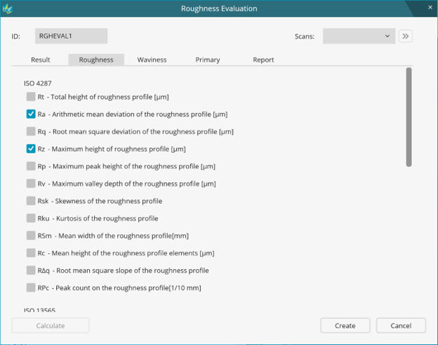

Roughness Tab
The Roughness tab in the Roughness Evaluation dialog box (Insert | Dimension | Roughness) displays the characteristics that PC-DMIS can calculate for a roughness profile.
Roughness tab
To select a characteristic, mark its check box. To unselect a characteristic, clear its check box.
PC-DMIS evaluates the roughness scan and displays the selected characteristics on the Result tab.
