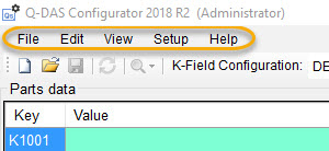

The menu bar lists the File, Edit, View, Setup, and Help items. When you click on any menu item, the item displays a list.
Menu bar
