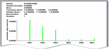

This establishes the correct origin for the alignment. PC-DMIS
inserts the Best
Fit 3D Alignment. Following execution, PC-DMIS displays a
3D Alignment Best Fit Graphical Analysis in the Report window.
