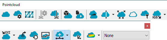

Pointcloud toolbar
The Pointcloud toolbar provides all pointcloud operations, features, and functions. You can access it from the View | Toolbars | Pointcloud menu, depending on your configuration.
All options may not be available. Some options require specific licensing to enable them.
The following options are available from this toolbar:

with the Activate Colormap option, see the "Show / Hide Colormaps"
section in the "Surface Colormap"
topic.
When you activate a new colormap, PC-DMIS displays its associated scale with tolerance values and any annotations in the Graphic Display window.
To activate a colormap from the Colormaps list, click the Colormaps list box and from the list of defined Colormap operators, select the colormap:
For details on the Pointcloud Surface Colormap operator, see "SURFACE COLORMAP" in the PC-DMIS Laser documentation.
Point Colormap - This button opens the Pointcloud Operator dialog box with the Point
Colormap operator selected. The Point Colormap operation evaluates the
deviations of the data points contained in a COP command compared to a
CAD object. You can use this command to color the entire Pointcloud, or
to display the points as dots, needles and/or text. For details on the
Pointcloud Point Colormap operator, see "POINT
Thickness Colormap - This button opens the Pointcloud Operator dialog box with the Thickness
Colormap operator selected. The Thickness Colormap allows you to show
and measure the part thickness as a colormap using only the Mesh or Pointcloud
(COP) data object. You can also compare the measured thickness to the
nominal CAD model thickness. For details on the Thickness
Colormap option, see "Pointcloud
Thickness Colormap" in this documentation.
