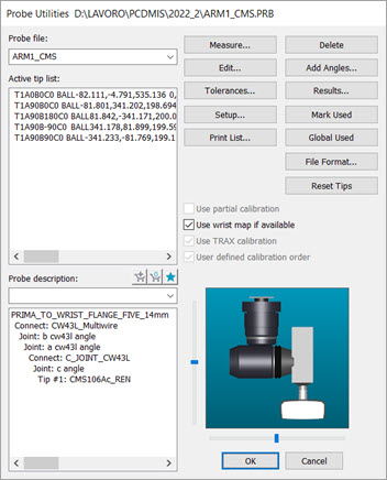

The following steps outline the procedure for mapping infinite wrist DCC HP-L laser sensors:
Define the sensor:
In the Probe Utilities dialog box, create a sensor as indicated below:
Infinitely indexable wrist, such as the CW43L
CJoint
HP-L laser sensor
For example:
Sample Probe Utilities dialog box with a HP-L laser sensor and a continuous wrist
Select the Use wrist map if available check box.
