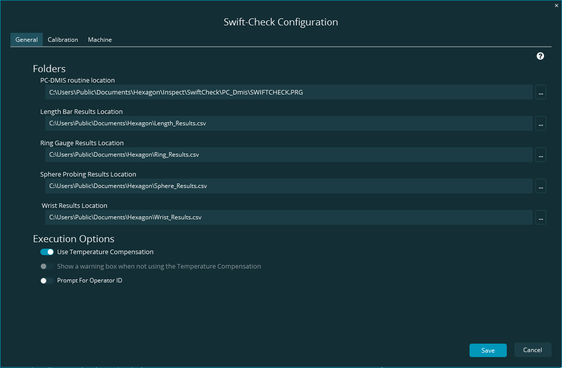

General Settings
Use the General tab to configure general Swift-Check settings.
Use the Folders area to define the folder that contains the Swift-Check measurement routine and where you want to store results files for the different Swift-Check tests.
Use the Execution Options area to customize what happens during execution.
