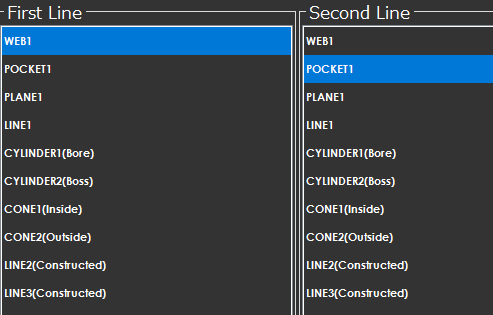

Select the type of angle evaluation you want to construct.
2
Select the features you want to use to construct the angle.
3
Once the features are selected, review the values on screen and make any adjustments to the nominal values if necessary.
4
Press OK to add the command to the measurement program.
Note
In the top-left corner of the Construction screen, there is an icon that shows the selected feature.
