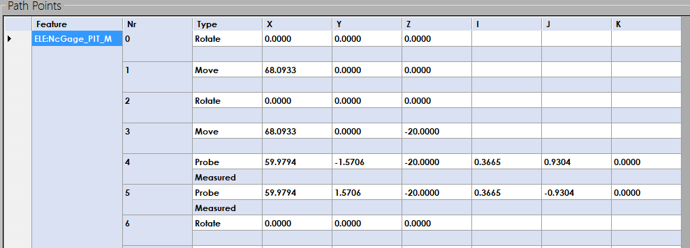

An example of a populated measurement path data table is shown below.
The measurement path data table includes:
  • The name of the feature that contains the path item (from the software used to generate the path)
  • The number of the path item
Individual path items can have these types:
Path Item Types
Type
Description
Move
Moves the machine to the coordinate: (X, Y, Z)
Rotate
Rotates the rotary axes of the machine to the positions: (A, B, C)
Probe
Probes the point (X, Y, Z) along the surface vector (I, J, K)
Measured
Displays the measured value for a Probe point after being measured
