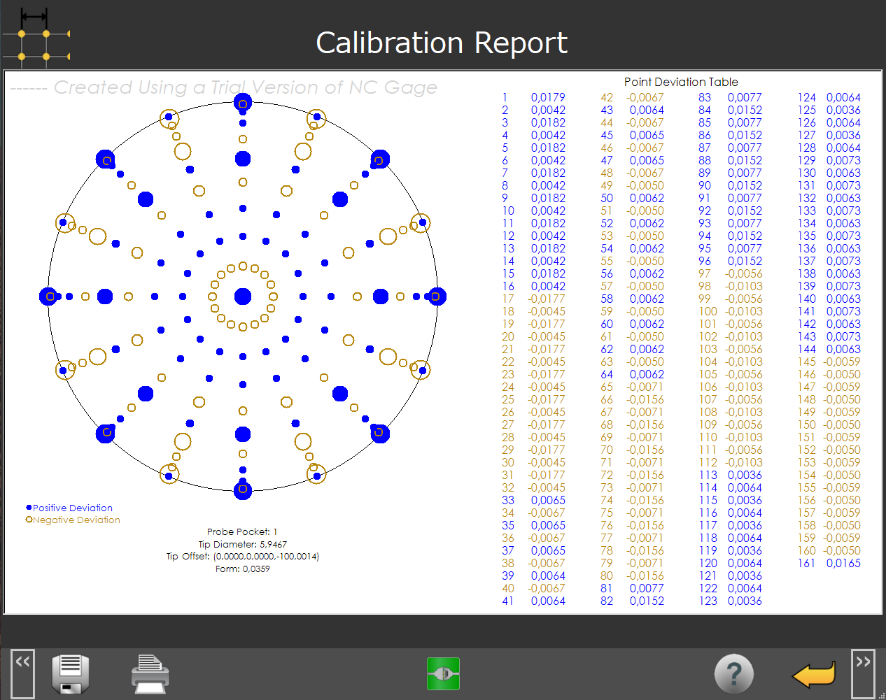

Calibration Report
This area shows the calibration results and every point measured, including a list of all the compensation values.
The different size circles and their colors in the graphic depict the relative size and direction of the point deviations:
  • Brown – Negative deviation
  • Blue – Positive deviations
