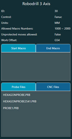

The Machine Details area of the main screen shows information about the selected machine.
The Start Macro tab lists the CNC code that the software adds to the beginning of the post. The End Macro tab lists the CNC code that the software adds to the end of the post. Both tabs show the same items, but the settings for each item may be different.
Start Macro and End Macro Tabs
The Start Macro and End Macro tabs show these items:
Start Macro and End Macro Tab Details
Item Name
Item Description
ID
This is the ID number assigned to the machine in NC Server.
Control
This is the controller type assigned to the machine in NC Server.
Units
This is the expected units (Inch or MM) for programs running on NC Server.
Allowed Macros
If the software specifies a range for this item, only programs with macro numbers within this range are posted out to the machine.
Unprotected moves allowed
If this item is enabled (set to True), the software uses G0 for moves between points in the posted program instead of G31.
Work Offset
If the software specifies a value for this item, it is always included in the posted program.
