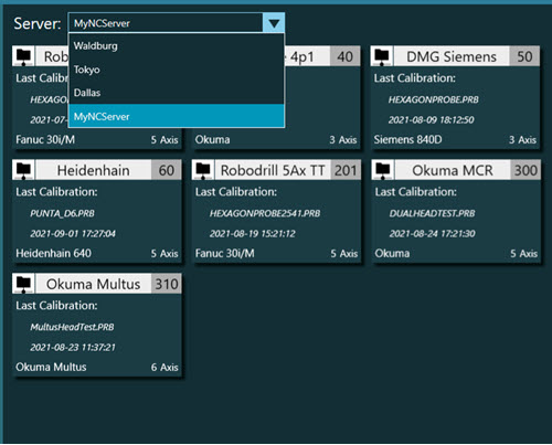

With the Server View area, you can view all the machines defined for a server and access its CNC and PC-DMIS files.
  1. From the main screen of NC Server Offline Manager, locate the Server View area.
  2. Then from the list at the top of that area, select an NC Server archive.
The software displays all the machines on the selected server as machine cards.
